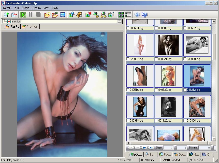

- moni.jpg (107.23 KiB) Viewed 12704 times
