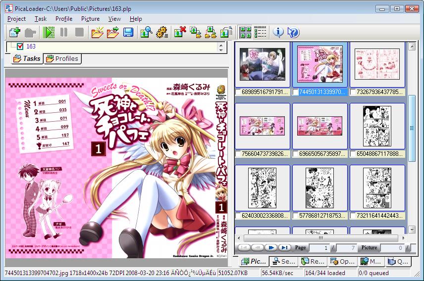

This is what happens
Could it be because I'm using Vista? =/ But for other sites it works..
works well on my vista.
you can post your project file here or leave me a private message :wink:
