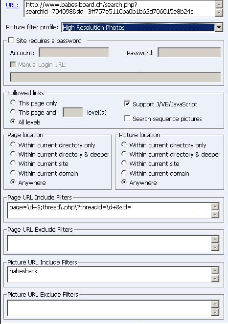

first step, login with your account and password using IE, then search "Jessica Alba" and copy the URL from IE's address bar.
second step, run PicaLoader, create a new task, paste the URL as start URL (it may change next time you search), and select High Resolution Photos of Picture Filter Profile, input page=\d+$;thread\.php\?threadid=\d+&sid= in Page URL Include Filter and input babeshack in Picture Include Filter.
third step, push Start button.

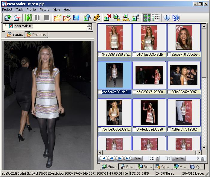

result
result
settings
settings

Thank you! You're pro!
I thought i could find it out by my self, but my help don't work, so i couldn't find any syntax for the regular expression in the filters!
Thanks a lot!
