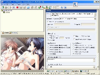

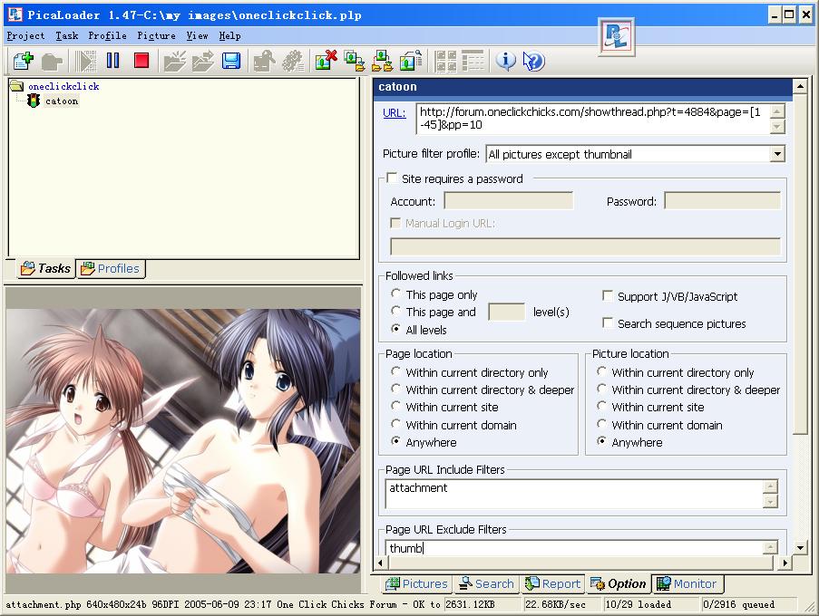

Then creat a task:
Start URL:http://forum.oneclickchicks.com/showthread.php?t=4884&page=[1-45]&pp=10
Picture filter profile:All pictures except thumbnail
Page URL Include Filters:attachment
Page URL Exclude Filters:thumb
Check the attached picture for detail.
