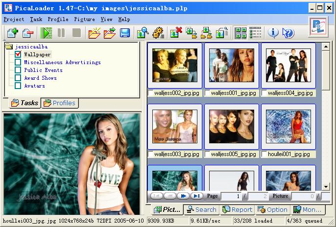

First, open IE cookie, login with "Remember me" checked.
Create a new project, set the default setting:
Page URL Include Filters: album=\d+$;album=\d+&pos=\d+$;pid=\d+&fullsize=1$
Picture URL Inlude Filters: /albums/
Picture URL Exclude Filters: normal_;thumb_
Then add new tasks, just set the start URL as the catalog's URL, e.g http://www.jessicaalba.at/index.php?cat=11 for wallpaper catalog.
Check the attached project for detail.
Don't forget to change the picture folder if you using my project directly.

Thanks, haven't tested it yet since i managed it in the end. I just set it to scan all the pages that are showing the "normal_" pictures and set up a filter in ad-muncher(a powerfull ad remover) to change all occurences of "/normal_<something>.jpg" into "/<something>.jpg" making the page showing the medium sized image with the normal_ prefix instead show the full size image, worked fine. Will try out your way and get back to you on how it works, but i did check the "remember me" box earlier.
