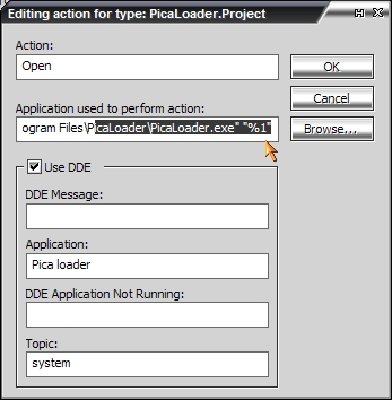

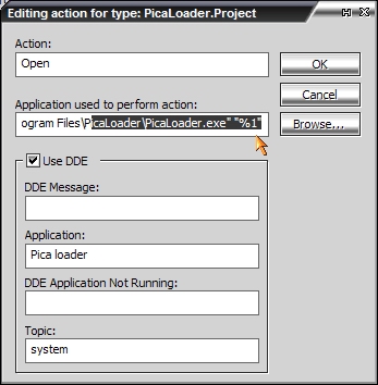

correct way plp files should be associated in win xp (sp2)
plp files open but give file not found in xp sp2 see below how to fix this error
using [open("%1"] in DDE message is incorrect and will cause this error
"drive:/Dir/program.exe"space"%1" with Application filled in and system in topic section will allow pl to load plp files correctly
pica loader you might want to fix this in your next release so the file association will work correctly also this error might be because acdsee fotoslate uses the plp extension also

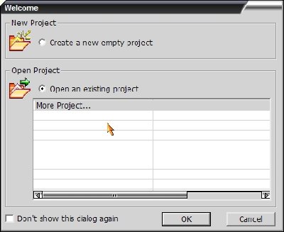

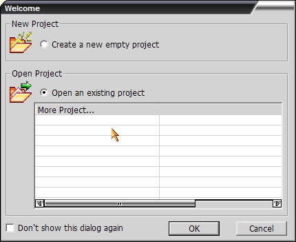

Projects are not added to welcome window
ok heres a bugger any projects new or old will not add to the project list which makes welcome screen obsolete but at least it doesn't crash trying to show this screen anymore

Q1: Fixed. If you already have some this kind of dir can't be delete, you can try this tool: http://www.vowsoft.com/UltraRmdir.zip (Just made by me, it's free. I had tested under Windows XP SP2 and Windows 2000 SP4, if it can't work on your system, please contact me.)
Q2: Fixed
Q3: PicaLoader get the recent projects via windows system recent document history, so if you set your system to "No Recent Document History", PicaLoader can't get the list... I will resolve this problem in the future (let PicaLoader record the history).
Thanks again!
