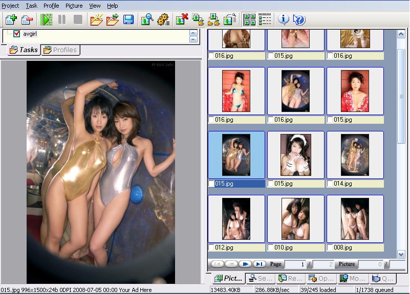

- result
- avg.jpg (91.42 KiB) Viewed 11350 times

Wow, works like charm. Thanks Koala!
