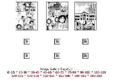

first, by analyzing the url http://www.imagecash.net/gallery.php?gid=263613&start=0 . we can see that the manga is seperated by several pages(see the picture below). the urls of pages are http://www.imagecash.net/gallery.php?gid=263613&start=0 , http://www.imagecash.net/gallery.php?gi ... 3&start=15 and .... these pages are what we would like to analyze(each page contains 15 pictures). since the urls do not match wildcard grammar, which i have discussed above. we need to create a task for each url(i do not think analyze the first with unlimited levels is a good idea, this method would cause waste of a lot of time for analyze unwanted url and may cause the problem i discussed in http://www.picaloader.com/forum/picaloa ... -t854.html).
so i suggest you set the "followed links" to be "this page and 1 level" to avoid picaloader analyze unwanted urls. check the option" support j/vb/javascript", because the page you are analyzing need javascript support. select picture filter profile "all pictures but thumbnails". since picaloader would take time for analyze the thumbnails, we can exclude thumbnails in the option "picture url exclude filter" by "/preview/"(this is the keyword in the urlsof thumbnail pictures).
