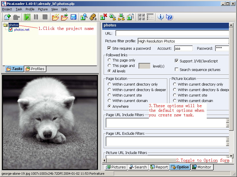

1.Defaults for tasks: please look at the attached picture.
2.Defaults for projects: please wait for next release of PicaLoader, comming soon!
