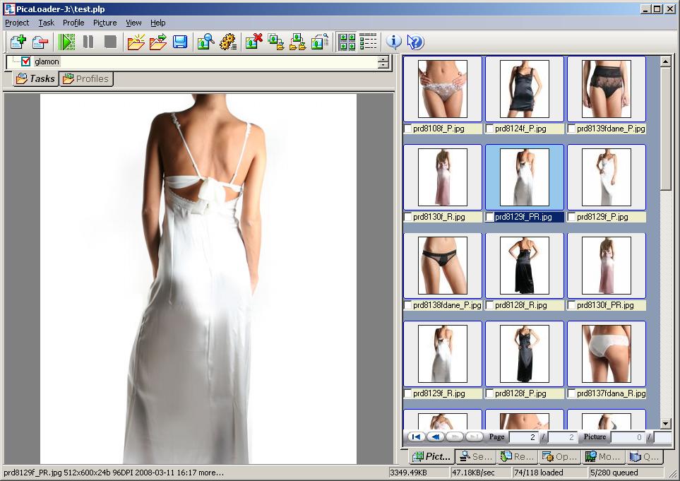

- laperla.JPG (85.74 KiB) Viewed 26577 times

- laperla1.JPG (83.45 KiB) Viewed 26541 times

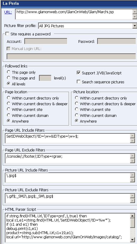

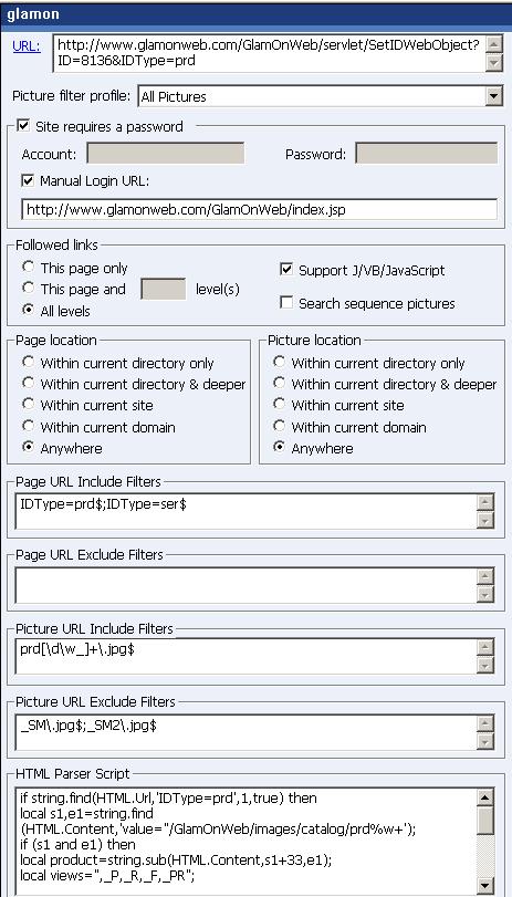

my settings
- result
- glamon2.jpg (105.22 KiB) Viewed 26464 times
- settings
- glamon2s.jpg (84.65 KiB) Viewed 26463 times
- glamon2.plt
- task export file
- (9.93 KiB) Downloaded 1007 times
