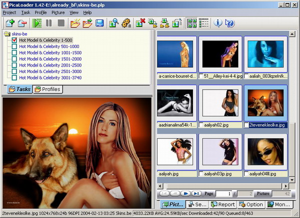

I check the site with IE and found picture display page URLs are sequential(I only interest in 1024X768 wallpapers):
http://www.skins.be/framepic.php?id=1&size=1024
http://www.skins.be/framepic.php?id=2&size=1024
http://www.skins.be/framepic.php?id=3740&size=1024
PicaLoader 1.42 support batch download this kind of URLs in one task, so we needn't to follow every links and reject useless.
I don't like to store more than 3000 pictures into one task, and don't like waiting for first picture after PicaLoader check more than 3000 pages, so I split it into 7 tasks, and download them one by one.
Check out attached project file for detail(you must have PicaLoader 1.42 or later installed).

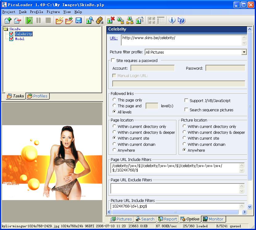

For download all celebrity's picture:
Create a new task:
Start URL:http://www.skins.be/celebrity/
Support J/VB/JavaScript disabled
Page Location:Within current site
Page URL Include Filters:/celebrity/\w+/$|/celebrity/\w+-\w+/$|/celebrity/\w+-\w+-\w+/$;/1024X768/$
Picture URL Include Filters:1024X768-\d+\.jpg$
For download all model's picture:
Create a new task:
Start URL:http://www.skins.be/model/
Page URL Include Filters:/model/\w+/$|/model/\w+-\w+/$|/model/\w+-\w+-\w+/$;/1024X768/$
You can replace the 1024X768 with the picture size that you intetrest in, e.g. 1680X1050 etc.
